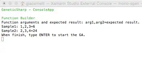

I have made a sample in my C# genetic algorithms library, GeneticSharp, that solves your question.
The sample called "Function Builder" receives the function's arguments values and the expected result, then, using genetic algorithms, it try to discover the math function.
Take a look:
GeneticSharp: Function Builder sample
