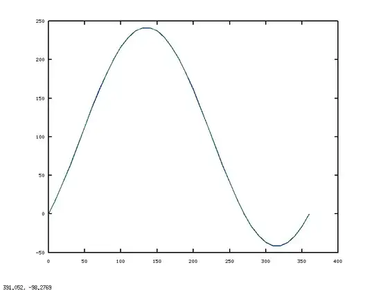

Let $f(x) = 142 \sin \frac{\pi (t -45)}{180}+100$. Then your data is reasonably well approximated by $\{t, f(t), f(360-t)\}_{t\in \{0,\cdots,360\}}$.
Here is a plot of $f$ and the first two columns of the data above:

    I dare guess that your $142$ might actually be $100\sqrt2$. – Jyrki Lahtonen Jun 23 '12 at 09:24
  • You might be right. All the data (at least the first 3 columns) are integers, so I would guess there was some rounding. The $2$-norm with $100 \sqrt{2}$ is slightly larger than with 142, but this may be due to rounding (I'm treating the data as a vector in $\mathbb{R}^{360}$). – copper.hat Jun 23 '12 at 14:53
  • brilliant! Thank you so much! – Nick Briz Jun 23 '12 at 21:26
