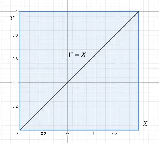

Renaming the rv's, $X$ and $Y$ as iid uniform distributions $X,Y \sim U[0,1],$ and the ratio $Z=Y/X,$ there are a few arithmetical and geometrical observations that suffice to derive both the pdf and cdf:
First off, the ratio can't be negative, since both $X$ and $Y$ are positive.
Second, observing the support of $Z$ in the Cartesian plane it is clear that it forms a square of area $1$ with a uniform distribution $f_{XY}(x,y)=1.$
Realizations of the rv $z=1$ will fall along the line $X=zY=Y$ corresponding to a slope of $1:$

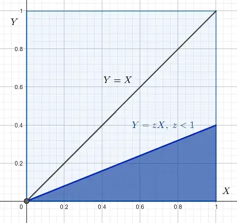

If $0\leq Z\leq 1,$ the intersection of the line with the right boundary of the square domain will be $(1,z),$ i.e. the slope of the line $(Z):$
The area in dark blue will be (given the independence and uniformity of $X$ and $Y)$ the probability $\Pr(Y/X\leq z)= \Pr(Y \leq zX)= \frac1 2 z.$

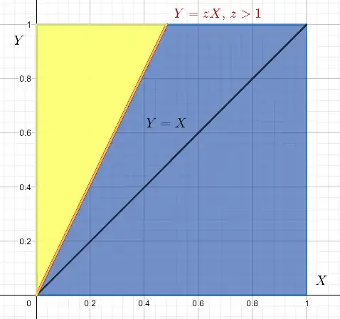

If, on the other hand, $z>1,$ the line will intersect the top margin of the square, at precisely $x = 1/z.$ The area below the line will be cumbersome to directly calculate, and it is hence much easier to get the complementary (yellow triangle):
as $\Pr(Y/X \leq z)=1 -\color{tan}\triangle=1 - \frac 1 {2z}$
