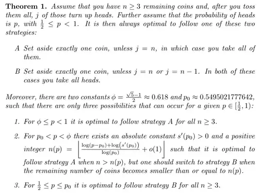

I just posted a paper on the arXiv that was inspired by this question. The paper deals with the slightly easier version of coins instead of dice. More precisely, we start out with $n$ coins that all have probability $p$ to land heads. After every toss we have to set aside at least one of the coins, and the goal of the game is to maximize the total number of heads we end up with.
One of the questions you asked was whether one can easily state the optimal strategy. As it turns out, this is indeed possible in this coin game, as long as $p \ge \frac{1}{2}$. Let me quote the main theorem I obtained:
For anyone interested, you can find the paper here.
