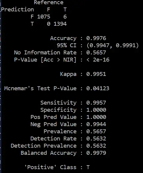

I am trying to run a binary classification problem on people with diabetes and non-diabetes.
For labeling my datasets, I followed a simple rule. If a person has T2DM in his medical records, we label him as positive cases (diabetes) and if he doesn't have T2DM, we label him as Non-T2DM.

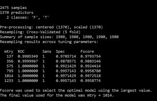

Since there are a lot of data points for each subject, meaning he has a lot of lab measurements, a lot of drugs taken, a lot of diagnoses recorded, etc, I end up with 1370 features for each patient.
In my training, I have 2475 patients and in my testing, I have 2475 patients. (I already tried 70:30. Now am trying 50:50 still the same result (as 70:30))
My results are too good to be true as shown below
Should I reduce the number of features? Is it overfitting? Should I retain only the top features like top 20 features, top 10 features etc? can help me understand why is this happening?

Assuming that these results are obtained on a valid test set with no data leakage, these results don't show overfitting because overfitting would cause great performance on the training set but significantly lower perfomance on the test set.
Make sure that your instances between the training and test set are truly distinct: there might be some data leakage, for example if there are duplicate records for the same patient.
Another potential flaw is the gold standard labeling: if the patient has this T2DM in their medical record, it means that they are already diagnosed right? And since the features are also based on the medical record, it's likely that this medical record contains direct indications about this diagnosis (for example in the drugs prescribed to the patient). There are two interpretations about this:
  • either the task is purposefully defined by this T2DM label, and in this case you can just enjoy the great performance but it's not technically about detecting diabetes in general.
  • or the goal is to detect patients with diabetes including the ones who are not diagnosed yet, but then it's likely that your gold standard is incorrect for this task.

Might be a case of Data leakage.
For 1370 features, 2475 is a very small dataset for such an extreme result.
Please try -
Inspecting the misclassified records.
Try removing the T2DM feature and note the dip
Repeat the last step for all the features. You must observe a negligible dip for other features and a very large dip for any feature which is causing the leakage.
