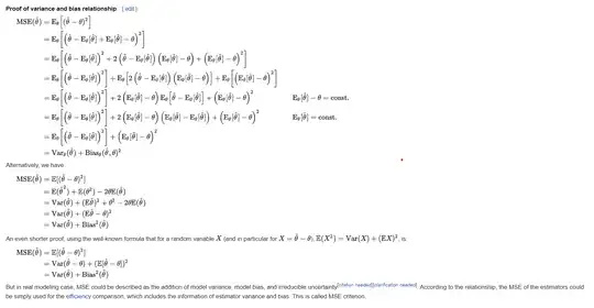

The proof for this has been clearly explained on wikipedia link
For more detailed discussion please refer to this Question on stackexchange
