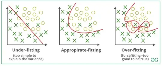

Check this link about Support Vector Machine.
You will directly understand bias and variance in classification. Basically, if your data is linearly separable you do not have a problem.
But imagine that your data is pseudo/semi linearly separable, however, few points land on the other side of their group.
Now imagine having a model that separates the data linearly, vs a model that will oscillate through the data so much to be able to classify correctly every point.
biasvariance
