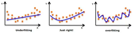

As a contrary example, here is evidence that deep learning is overfitting. An overfit model is easy to fool since it has incorporated deterministic/stochastic noise. See the following image for an example of overfitting.
Example of underfitting, fitting, and overfitting.
Also, see lower ranked answers to this question to understand the problems with an overfit model despite good accuracy on test data.
