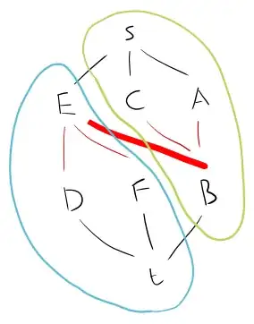

The solution given is clearly incorrect, as you demonstrate with the counterexample. Note that the graph U+V is a connected component by the infinite-capacity edges. Therefore every valid cut will have to contain all of A, B, C, D, E, F on the same side.
Trying to trace back where the solution came from: http://www.cs.washington.edu/education/courses/cse521/01sp/flownotes.pdf cites Network Flows, by Ahuja, Magnanti, and Orlin for some of the problems. This book is out of copyright and downloadable from http://archive.org/details/networkflows00ahuj but it doesn't seem to contain this problem and solution (searching for every occurrence of "bipartite").
Note that the explanation paragraph of the solution does not show that the smallest cut of the graph it constructs corresponds to the maximum independent set. It only shows a way to get an independent set.
And yet, you can see what the algorithm is trying to do. Here is what the actual maximum independent set corresponds to in terms of its s,t cut:
Graph
The infinite-capacity edge that breaks the algorithm is emphasised.
I'm not sure how to fix the algorithm to what was intended. Maybe the cost of an infinite edge should be zero if it goes backwards (i.e. where it goes from S to T, but crosses from t-side to s-side)? But is it still easy to find the min-cut/max-flow with this nonlinearity? Also, thinking of a way to bridge from @Jukka Suomela's solution to the algorithm from the question, there is a difficulty where we go from the maximum matching to the minimum vertex cover: while finding the maximum matching can be done by a max-flow-like algorithm, how do you recover the minimum vertex cover from it using a flow-like algorithm? As described here, after the maximum matching is found, the edges between U and V become directed to find the minimum vertex cover. So, again, this doesn't show that a simple application of min-cut/max-flow is all it takes to solve this problem.
