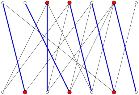

As JeffE mentions in a comment, a grid graph is an example of a bipartite graph. If you take a bipartite graph, and remove some of the vertices, it will still be a bipartite graph.
Königs Theorem states, that for bipartite graphs, the number of vertices in a minimum covering, equals the number of edges in a maximum matching.
As mentioned in the answer for Maximum Independent Set of a Bipartite Graph:
The complement of a maximum independent set is a minimum vertex cover
What you are asking, is how to find a maximum independent set in a grid graph with some vertices removed, and the way to do that, is to use some of the algorithms for finding a maximum matching in a bipartite graph, from that construct a minimum vertex cover, and then invert it to get a maximum independent set.
The figure below shows a bipartite graph with a maximum matching (in blue), a minimum vertex cover (in red) and consequently also a maximum independent set (in white):
from Wikipedias article on Königs Theorem
