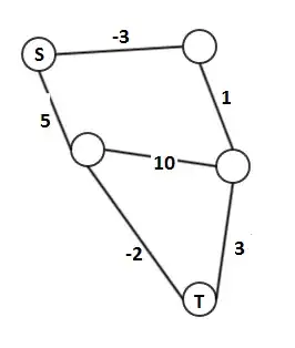

I know this is probably very basic, I just can't wrap my head around it.
We recently studied about Dijkstra's algorithm for finding the shortest path between two vertices on a weighted graph.
My professor said this algorithm will not work on a graph with negative edges, so I tried to figure out what could be wrong with shifting all the edges weights by a positive number, so that they all be positive, when the input graph has negative edges in it.
For example, let's consider the following input graph:
input graph

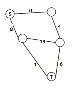

Now if I'll add 3 to all edges, it's obvious that the shortest path (between $s$ and $t$) has changed: graph after adding 3
Thus this kind of operation might result in wrong output.
And this, basically, what I don't get. Why does this happen? Why is shifting the values has such a dramatic effect on the shortest path? This is totally counter-intuitive, at least for me.

Dijkstra relies on one "simple" fact: if all weights are non-negative, adding an edge can never make a path shorter. That's why picking the shortest candidate edge (local optimality) always ends up being correct (global optimality).
If that is not the case, the "frontier" of candidate edges does not send the right signals; a cheap edge might lure you down a path with positive weights while an expensive one hides a path with negative weights.
For details, I recommend you check out a correctness proof and try to do it with negative weights; observe where it breaks.

Adding a constant amount to each edge length can change the shortest path for the simple reason that it increases the length of a path with many edges by more than it increases the length of a path with only a few edges.
For a simple case, consider the graph with vertices $\{a,b,c\}$ and edges $\{ab,bc,ac\}$, where $ab$ and $bc$ have length $1$ and $ac$ has length $3$. The shortest $a$–$c$ path is $abc$ with length $2$. However, if you increase each edge's length by $2$, then the length of $abc$ increases by $4$, while the length of $ac$ increases only by $2$. So, now, $ac$ is the shortest path, with length $5$ versus $6$.

And adding some positive number X to all the edges just to make them positive doesn't result in correct answer. Shortest distance can be P through one path and P1 through another path containing number of edges N and N1 respectively , suppose P > P1 but P1 has more edges than P , that might actually make P less than P1 since P's distance is added to N * whatever the actual number u added to all the edges and thus results in a wrong answer!!
