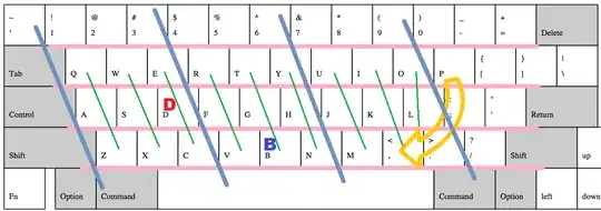

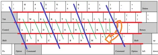

I'm not sure how secure this is (posting here will probably reduce its security at least a little), or whether it would necessarily even be called a hash function, but in terms of input/output (keyboard keys), memory (I think about 3 chunks beyond the piece being manipulated at a time), speed (a couple minutes to produce around 8-16 characters), materials (keyboard), side-channel attacks (only the output is ever written down), instruction set (visual manipulation in your head), I think this algorithm I came up with a few years ago for generating passwords is hard to beat.
There are 26 letters in the English alphabet, which just so happens to be 1 less than 33. Look down at your (QWERTY) keyboard. Now look at me. What you just saw were three rows of letters, containing 10, 9, and 7 letters each. Mentally move the "P" down to where the "," is, and now each row has 9 or fewer keys in it. Now mentally separate the keyboard into 3 regions containing 3 columns. Every key can now be denoted by a base-3 3-tuple specifying row, section, and column within the section. Don't worry, you will never need to write down the 3-tuple, or even know what a tuple is; that bit is for explanation purposes only. Basically, you want to create this mental image: Dividing the Keyboard Into Thirds Three Ways
The other thing you will need is a seed word. For passwords, 5 characters will generate 5 letter-number combinations for 10 digits (if you don't mind hashing only partway through your input); if you want to hash something longer, you will obviously need a longer seed.
Now, for the algorithm:
For each pair of letters from the input and the seed, find the letters on the keyboard. I am using "D" and "B" for the input and seed, respectively. B and D are selected
Now, you don't need to convert the letters into coordinates! You only need to figure out one coordinate at a time. And don't think of them as 1,2,3, think of them as (left, middle, right), and (top, middle, bottom) - or better yet, don't think of them at all; just picture their locations. For the purposes of explanation, I am going to convert them anyway:
  • B is in the middle section, in the middle column, on the bottom row.
  • D is in the left section, in the right column, on the middle row.
Now, to reassemble the output, we're going to need to map pieces of each of the inputs to our output. How exactly this is done is to be determined by the user; just make sure you always map the same way every time. And make sure you use at least one component from the input and at least one component from the seed.
An example mapping could be (input column -> output section, seed row -> output column, input section -> output row). An easy and more memorable way to work this in your head is to picture each input piece rotating/sliding to where it maps to on the output (starting with whatever maps to the output section will usually be the easiest to do first, regardless of what maps to what).
So (since animations are beyond what I can do right now):
  1. Input (D) column (right): A, S, and D expand out to correspond to the left, middle, and right sections. Picture subsequent steps happening in the right section.
  2. Seed (B) row (bottom): T, G, and B rotate to the horizontal and slide over to the right section, where they correspond to the columns headed by U, I, and O. Picture the last step happening in the O column.
  3. Input (D) section (left): The left, middle, and right sections shrink and rotate vertically to overlay O, L, and P (which was borrowed from the top row). The output letter is O.
Now, I promised that the output would be a letter and a number. Don't forget that we have used only 3 of the 6 available coordinates. You can map two of the remaining three coordinates to the number row, which is divided into 3 rows of 3 numbers (ignoring the 0 or any other number you don't happen to like). This leaves one remaining coordinate, which you can use to determine whether you should hold Shift when you're hitting a letter, or a number, or both, or neither (only 3 of the 4 options will be available, so choose wisely). I do recommend having that coordinate come from the seed, so you can choose a seed word that will ensure password suitability if you are using this for that purpose.
I do see some potential problems with reverse-engineering your algorithm/seed if someone can get a hold of enough input/output pairs; but hopefully the method used will obscure it enough to make it difficult. You can always use a different coordinate mapping or seed word if concerned. Like I said, I don't know if this would be secure enough for anything other than passwords, but it is potentially useful for people who might have trouble doing more complex calculations in their heads. And no intermediate steps are ever recorded!
