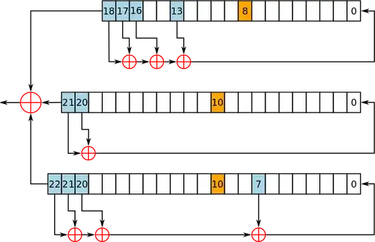

I think it is viable to execute GSM's A5/1 algorithm manually by preparing roughly 40 to 50 pieces of 1s and 0s or 80 to 100 in total (assuming that out of 64 bits of state roughly 50% are 1s and 50% 0s).
The 64-bit commitment would be used as the initial state (19 + 22 + 23 = 64) and the revealed value is for example 128 bits of the steam output. Perhaps first 128 or 256 bits should be discarded to hide the internal state better and make it more costly to find a collision.
This is still quite verbose algorithm to run by hand and mistakes are easy to make. Also I have no clue about its pre-image resistance. Other (ad-hoc?) LFSR-based system would be easier to simulate but wouldn't be as secure.
