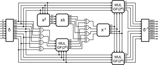

There's a paper by Satoshi et al that I used for the mathematics, which gives $$\left(n_1x+n_0\right)^{-1}=n_1\left(n_1^2\lambda+ n_0\left(n_1+n_0\right)\right)^{-1}x +\left(n_0x+n_1\right)\left(n_1^2\lambda+n_0\left(n_1+n_0\right)\right)^{-1},$$ which becomes the following circuit:
SBOX
You would have to make a bit-slice implementation for each of those blocks in the figure. And having done that, i'm going to guess that in a C implementation it's going to be 100x slower at a minimum than just using a lookup table, but I do not believe that you will leak any useful data because there's no way to identify from cache misses or power the values that you are calculating.
