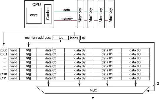

The cache let's you skip the access if you already happen to have that data in the cache. There are many forms of cache from direct mapped (1-way) to fully associative caches. ( used to spend 2 weeks on this topic alone due to practical hardware issues, so this is the short-short version) In the simplest form, you have something that looks like this:
Cache example
The "tag" is the upper address, and the index in the row in the array. I use the last few bits for the output control. The "valid" column is a counter of some modulo. When I access the memory, I reset the counter. I did not include bits to do further control in the image. These bits can set all sort of other cache behaviors.
This is the origin of the cache timing attack. It takes me more time to go out to memory. The last time that data was constant time from memory was 30 years ago. The 80286 and 68010 both had caches, and "Big O" notation sort of went out the window with that in a practical sense.
