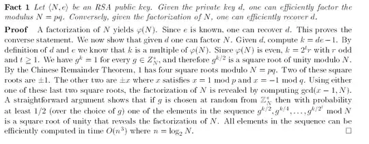

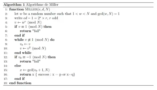

The answer of @robert-mason is good but rather large.
Here is the algorithm and the proof just after.
Source of the proof here (at the end of part 1).
