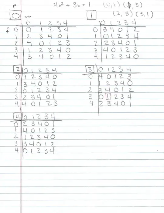

Taking the question as literally as possible, I have provided my pencil and paper tables for a scheme among three parties with a polynomial of degree 2 and a field of $\mathbb{Z}_5$ to keep things feasible for a pencil and paper example. Given the tables, in order to reconstruct any secret look up the table to be used by the share from party 1 (table numbers are denoted in a box to the upper left of each table), the row to be used by the share from party 2 and the column to be used by the share for party 3.
I've provided an example polynomial $4x^2+3x+1$ which evaluates correctly to 1, the secret, at $x=0$, 3 when $x=1$, 3 when $x=2$, and finally 1 when $x=3$. Then, to reveal the secret, take these shares and look them up as described. I've boxed in red the correct value from following the described procedure. This set of tables should work for any polynomial valid in the field described and for shares based on players associated with the same values for $x$. Shamir Tables for a polynomial of degree 2 and a field <span class=$\mathbb{Z}_5$">
