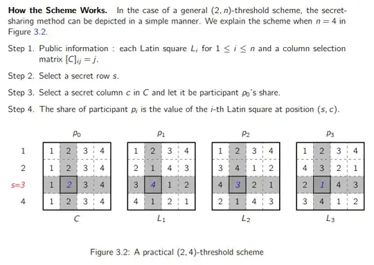

2-of-4 secret sharing scheme using Latin squares.
From page 45 of this very interesting paper.
What about other m-out-of-n schemes? In particular 2-out-of-4, 2-out-of-5, 3-out-of-4?
