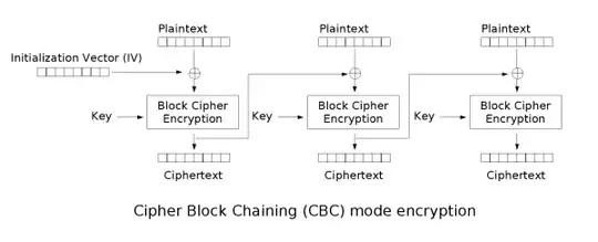

11
If you look at the CBC diagram, you'll see that having a fixed IV is equivalent to having the first ciphertext block become the IV. If your cipher is a good pseudorandom permutation, then what you are doing does work, if and only if all timestamps are unique such that the "new IV" is unique and unpredictable.

Sure, that's fine, but you're really just using the first block of ciphertext as the IV.
If you choose the first plaintext block to be a running message counter (which you might as well do; it's easier than generating a random block) and your "discarded IV" to be all zeros (or vice versa) then your method is equivalent to standard CBC mode combined with the "encrypted counter" method of IV generation as described in Appendix C of NIST SP 800-38A:
