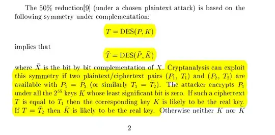

I was reading upon Biham and Shamir's paper and a fact has been presented over there: if $ P_1 = \bar P_2$ and I choose a key $K_1 = \bar K_2$ then in that case $$T_1 = DES(P_1, K_1)$$ $$T_2 = DES(P_2, K_2)$$
then $T_1 = \bar T_2$ . Does this hold for only that particular combination of S-box or it will be same for any S-box combination. I mean if I change S-boxes randomly then will it still be same?
Also there is one more thing mentioned on the paper, but I am not able to get it. PFB the image.
Here output $T$ will be $\bar T_2$ only if I $P_2$ was inserted with $\bar K$. And clearly I am entering $P_1$ (which is $\bar P_2$) hence the output can never be $T_2$. Please correct.

This is known as the complementation property of $DES$; I had thought that it actually predated Biham and Shamir's work.
In any case, your questions:
Does this hold for only that particular combination of $S$-Box or it will be same for any $S$-Box combination?
It'd remain even if you change the $S$-Boxes arbitrarily. The reason for this is that it is not actually caused by the $S$-Boxes. $DES$ generates the inputs to the $S$-Boxes by $XOR$ing $R_i$ with $k_i$. The reason this property holds is if you complement $R_i$ with $k_i$, the result of the $XOR$ won't change, and so the input the to $S$-Box is exactly the same (and hence the output of the $S$-Box is exactly the same).
Actually, that's a fairly straight-forward exploit of this property. I'll see if I can state it more explicitly.
Suppose you knew the ciphertexts for two plaintexts, and these plaintexts happened to be the complement of each other. That is, we know the value $T_1 = E_k(P_1)$ and we also know the value $T_2 = E_k(P_2)$, where $P_1$ and $P_2$ are complements of each other (that is, wherever $P_1$ has a $0$ bit, $P_2$ has a $1$ bit, or in other words, $\overline{P_1} = P_2$
Consider further that we don't know the key $k$; and we'd like to find it.
One thing we can try is pick a random key $k'$, and do a trial encryption of $P_1$ with it. If our $k'$ just happened to be the value $k$, then $E_{k'}(P_1)$ would be $T_1$, and so we know know that $k'$ is likely to be the correct value.
However, consider if our $k'$ is the complement of $k$ (that is, we got every bit wrong). In that case, the key complementation property would hold, and we would have $E_{k'}(P_1) = \overline{E_{\overline{k'}}(\overline{P_1})} = \overline{E_k(P_2)} = \overline{T_2}$, that is, we would see the bitwise complement of $T_2$. So, if we see that value, that also tells us what the key is likely to be.
Hence, by doing a single $DES$ encryption, we can actually test two keys -- that's what Biham and Shamir are pointing out.

I would like to add my own view/explanation on that problem based on the textbook you provided. We will follow the provided explanation:
Reminder $ \overline{DES_k(P_1)} = DES_\bar{k}(\overline{P_1})$
For all {k'} such that $k\in$ {all Keys with last bit is 0}
1.if $DES_{k'}(P_1) = C_1$ we have the k
2.if $DES_{k'}(\bar{P_1}) = \overline{C_1}$ we have the coplement key i.e the real key is the opposite
We are iterating on all domain of keys with last bit 0.
The key can have 1 or 0 as the last bit.
if the real key has 0 at the end we must find it in first condition (we check all domain)
if the real key has 1 at the end we must find it in the second condition because the complementary of such key must have 0 at the end and we are iterating on all domain.
