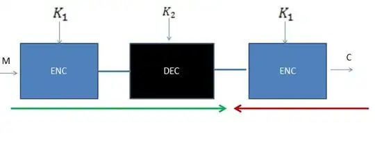

yes,it is possible because in meet in the middle attack on 3DES,see below enter image description here with Complementation Property of DES in red arrow,you can search $2^{55}$ key space instead of $2^{56}$,and for green arrow,you have $DEC_{K2}(ENC_{K1}(M))$ that without key Complementation Property,you need $2^{112}$ operations but with key Complementation Property of left ENC and middle DEC block,you need $2^{110}$ operation and in total you need $2^{55}+2^{110}\approx 2^{110}$ operations
NOTE: in green keyspace(arrow), you should calculate one encryption and then one decryption for your known plaintext,for both decryption and encryption of DES,if you test one pair key($K_{1}$ and $K_{2}$) and calculate the middle variable,because of Complementation Property of DES,you don't need to have a decryption and encryption for $K'_{1}$ and $K'_{2}$ so with every calculate of $DEC_{K2}(ENC_{K1}(M))$,you test 4=$2^2$ keys
