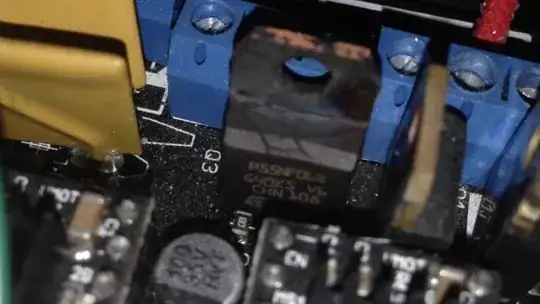

The next section of the thread deals with an overheated (50 A?) MOSFET. Check the condition of that:
ok think i found the culprit, any ideas why that blew?
Burnt MOSFET
A couple of good points
With the bed I found there are 2 issues at play here.
  1. The standard MOSFET that is typically found in theese kits have an RDS that creates a fair amount of heat at 10A and at this level the datasheet says stick a heatsink on. Screwing a piece of metal to the MOSFET cures the issue I use an aluminium bracket because thats what I had laying around, thermal compound helps too if you have that laying around from a PC.
  2. A lot of heat beds state that they are 1.2ohms but aren't ( just a variance in manufacturing prehaps? ) sticking a cheap multimeter across it says this but in practice it may not be reading correctly. I found this out because my bed kept tripping a 11A polyfuse but was fine with a 12A meaning its somewhere around 1.1ohms. good news is it means my bed heats up slightly faster!
but seeming as your transistor blew I imagine the polyfuse is ok, watch out though you may find it slowly does kick in when the MOSFET works properly because if its near its tripping point it can gently heat up and stop the current.

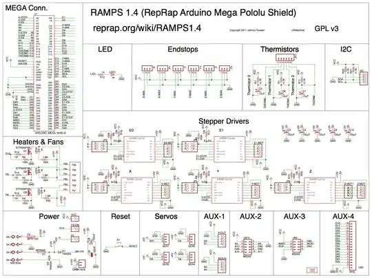

A good test procedure - this is probably the most relevant check for your case
That's not the way it's wired. Check the schematic.
12V input on RAMPS -- fuse -- (PS1) + output to BED
GND -- Source[MOSFET]Drain -- (PS2) - output to BED D8 ---------------- Gate
As you can see, the MOSFET is switching the GND connection to the bed. There will always be +12V on the + bed terminal whenever power is on as long as the fuse is good. There's an LED across the + and - BED terminal on RAMPS to indicate voltage. If that LED is turning on when you turn the heated bed on from the host software, then the MOSFET is good. If it's not coming on, they you might have a bad MOSFET or your +12V supply is bad. Verify using a voltmeter across the bed terminals and across the 12V bed supply input in RAMPS.
The Prusa heated bed PCB should have a resistance around 1.1 ohm.
RAMPS Schematic
