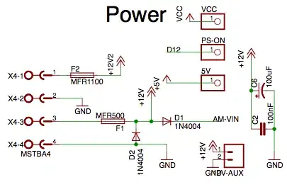

Assuming the (most common and standard) RAMPS 1.4 board, the power input section looks like this:
RAMPS 1.4 schematic - power input section
There are two 12V input sections: one for the heated bed (with an 11A fuse) and one for the rest (with a 5A fuse). If only one of the sections has reversed polarity (and the other one is connected correctly) the power supply (assuming a single supply is used) is shorted out directly through the board (without any fuses or any other protection). This will in principle not damage any components on the board, but it might damage the power supply or melt the wires. In the following, I assume both sections have polarity reversed consistently (or one of the sections is not connected at all).
The bed input section basically has no protection. If polarity to the bed is reversed, the bed MOSFET's body diode will conduct - basically shorting out the input through the fuse. The current that will flow will initially only be limited by the power supply's ability to supply current. Eventually the fuse will trip, but these poly fuses are quite slow and in the meantime it is possible the bed MOSFET will be damaged (which might cause it to permanently conduct, i.e. the bed might always be on, or the MOSFET might become a short circuit and short out the power supply even if the polarity is corrected).
The 5A section has a bit more in terms of protection. After the fuse there is a diode (D2) that shorts out the power supply if polarity is reversed. This is similar to how the diode in the bed MOSFET shorts out, but in this case the diode is dedicated for just this function. The diode has a relatively low forward voltage, lower than that of the MOSFETs for the heaters, so in principle these components will be protected. However, the diode is not really rated for the kind of current that would flow in this scenario, so components such as the heater/fan MOSFETs and stepper drivers might be exposed to a reverse voltage (albeit around -2V at most). They would probably survive.
As in the heated bed scenario, the diode D2 would probably be damaged - it would likely end up short circuited and thus needs to be replaced (or at least removed, but this is not advisable since it's required for polarity protection) before the board will function again.
The Arduino Mega 12V input is protected through a blocking diode (D1) which will fully protect it. This diode will not be damaged, because it won't conduct any current in a short-circuit scenario.
It might seem kind of strange a diode is used to deliberately short out the input in case of reverse polarity, and you might ask why the design doesn't simply use a diode to block the reverse flow of current (like is done for the Arduino). The reason for this is that all diodes have an associated voltage drop, which would cause a lot of power loss (especially for the heated bed), requiring a large diode with heat sink. The way the diodes are placed (i.e., shorting out the power rails in the event of reverse polarity) avoids this loss and still somewhat protects the electronics down the stream (even if the fuses/diodes are blown). Note that this is still a less than ideal solution, if you're trying to design your own reverse polarity protection solution then I would recommend to go with a MOSFET-based solution.
