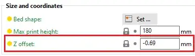

    • PrusaSlicer
      Navigate to Printer Settings > Size and coordinates > Z offset. Requires an advanced view mode.
      PrusaSlicer Z-offset setting

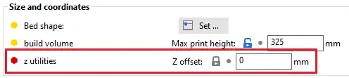

    • SuperSlicer
      Navigate to Printer Settings > Size and coordinates > Z offset. Requires an expert view mode.
      SuperSlicer Z-offset setting
