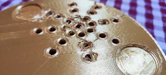

I'm facing a weird problem I cannot understand why it happens. Most of my objects have a large planar base so I don't have any adhesion issue. I'm using a PLA Silk gold filament from eSun (filament dryer is on while printing) and a Dremel 3D45 printer.
This is the bottom (first layer) of an object printed directly on the (glass) bed:

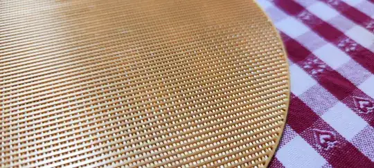

Then I tried another object (very similar) using a raft. The raft itself is almost perfect:

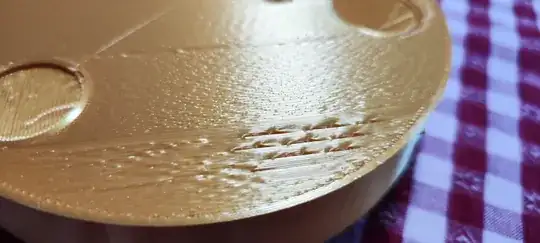

But, again, the first layer of the actual object (only 0,1 mm air gap from the raft) has the same problems of the first one:

Based on the scarring and the appearance of the printed holes, it looks as if the nozzle to bed distance is not good, it is probably too large (could be too close as well, if you consider the scarring where the nozzle might have picked up already deposited material). The bed is also quite hot, for PLA you could drop this to 50 °C
Note that an initial layer height of 0.3 mm is also quite large, it causes a lot of material to be deposited while there might be too much/too little room for the amount. Printing on glass should give you a shiny mirror glaze finish (unless the glass is textured); the images don't express that feature from printing on glass build platforms.
A raft generally shouldn't be necessary for PLA (but some exceptions may apply), but certainly not for large planar based prints with a decent amount of surface area in contact with the bed. It is hard to get a nice surface on top of a raft/support structure.
Rafts generally print very well as there is extra space in between the deposited lines, and there usually is some over-extrusion.
