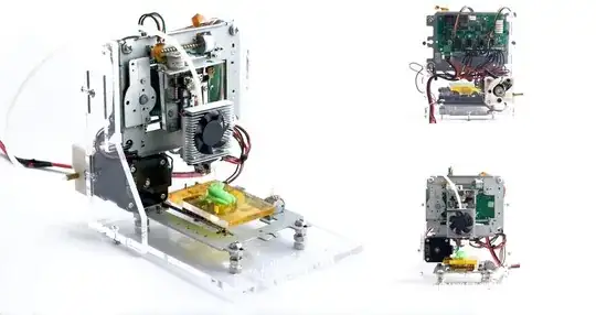

I would guess that a printer made in the following way would be both poor quality, and annoyingly frustrating, as well as requiring constant tinkering/re-adjustment. Also, if the chassis of the CD/DVD drive is incorporated into the design (as below) then the print volume is rather small, given the inherent limited movement of a CD/DVD mechanism.
If the steppers are used without the CD/DVD chassis then it might be possible to increase the print volume but then you would need to spend extra on the rods and support structure for the X gantry, the Y-axis print bed, and the Z-axis movement. If you do that, then the steppers from the CD/DVD drive probably would not have sufficient torque to move the additional weight - by incorporating the CD/DVD chassis the inertia of the movement has been kept to an acceptable minimum.
By using the CD/DVD drive's stepper motors you are only really saving the cost of buying three or four actual, more powerful and useful, stepper motors (as well as the cost of the additional rods and support).

There is this (IMHO unjustifiably1) popular (i.e. well linked-to) Instructables guide: EWaste 60$ 3DPrinter, which describes making a 3D printer from old desktop computer parts2.
According to E-waste printer looks nice, prints really, really small, it has an awesome print volume of 37 mm x 37 mm x 18 mm.

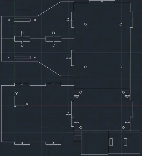

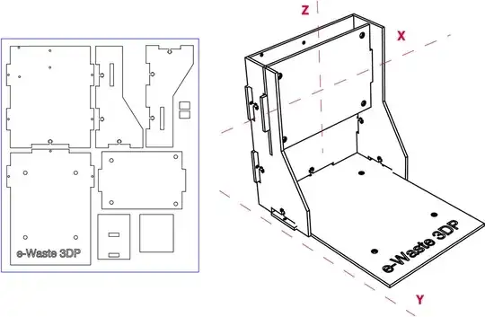

To make the frame, you need a 325 mm x 362 mm, 5 mm thick acrylic sheet, and use this template (missing files):
or this one (cnc-calisma-yalniz.dwg):

1 Most, if not all, of the links for the printer above are dead (this variant, mentioned above in Other links, is much more complete). However, with a bit of knowledge, and common sense, it should be possible to work through those omissions:
- Marlin software - easy enough to find on Github
- The frame laser cut - the original file is missing but an alternative is still available
