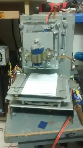

I'm trying to create a 3D printer based on this instructable, EWaste 60$ 3DPrinter.

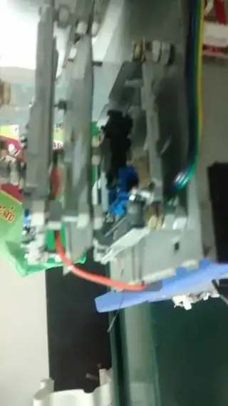

I have followed the steps provided there, and I'm facing the problem that the x-axis isn't able to move, i.e. the motor works fine but the z-axis part which is connected to x-axis doesn't move left and right. I have tried the following already:
  1. Changed the design of 3d printer by attaching x-axis with y-axis and leaving z-axis separately
  2. I gave a little force to the z-axis part and it starts to move left and right.
Any help on this would be appreciated!

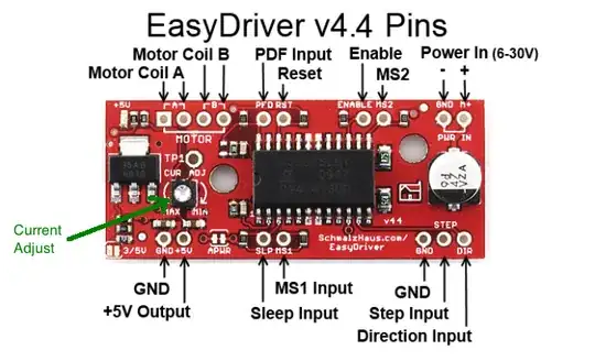

I would suggest removing the Z-axis from the X-axis CD carriage, in order to reduce the mass and therefore the power required to move it, and test the X-axis in isolation. If it moves left and right correctly, then it is not dead (obviously). If it does not move, then try adjusting (increasing) the current to the stepper motor, by adjusting the EasyDriver (assuming that you are using an EasyDriver stepper motor controller):
EasyDriver current adjust
If it still does not move, then replace the stepper (or the whole X-axis CD-ROM drive, which is probably easier).
Then replace the Z-axis and test the X-axis movement again. If it does not move then the stepper does not have sufficient power, or strength, to move the mass of the Z-axis and, again, will probably require increasing the current to it, by adjusting the EasyDriver (as above):
  • If that does not help, then it will probably need need replacing.
  • If it does move, then you've fixed it.
