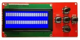

  • LED comes up with all white blocks and buttons do nothing

The display of the Anet A8 now shows white blocks.

This is a known and documented problem of this printer. I'm afraid your printer board is dead.
If you have white squares on the display like this picture: enter image description here
You need to check Anet A8's mainboard - click reset button and check the D1 indicator: enter image description here
  • If D1 lights on for a second then went out and the screen is full of white square, try to reconnect screen wire for several times. When it's well connected, click the reset button. If still not working, you need to replace a screen.
  • If the D1 indicator is always off and the screen is full of white square, you need to replace a mainboard.
From the video you posted it can be seen that the D1 LED does not light up, it is off the whole time. Hence the main board is dead.
