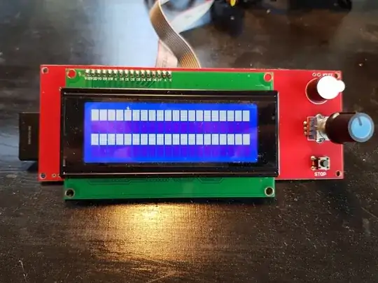

  • Replaced LCD / Smart controller

  • Replaced LCD Display / Smart Controller
I replaced the Arduino on my I3 MK3 and have tried to flash firmware V 3.8.0. The AVRDUDE logs in Prusaslicer say the flash succeed. I haven't gotten any response from the printer. I also replaced the LCD display / Smart Interface to see if it was faulty.
The screen displays the same block-bar pattern. The heat bed starts to hear up, as well as the extruder tip, the extruder fan also runs. There is no response from the dial on the LCD display / interface. When I try to engage any of the stepper motors using Pronterface, nothing happens.

  • I used Marlin 1.1.9 firmware and compiled and loaded it using the Arduino IDE. The printer works now. I was trying to use incompatible firmware. – JamesJSkier Sep 24 '19 at 22:27
    Very good first question, welcome to 3DP.SE! – 0scar Sep 25 '19 at 05:01
    Although Prusa is a brand and the i3 and MK3 the model, it has become a model name for many other brands. Only if you have an original Prusa (you will know as they are more expensive than the clones) you can use the Prusa specific firmware, else you need to revert to e.g. open source alternatives as Repetier and Marlin or many more. Note that the Prusa firmware is based on Marlin, but only applicable to Prusa machines. – 0scar Sep 25 '19 at 11:12
