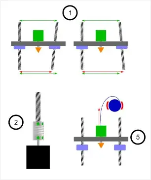

I assume you did everything according to the instructions but here is a checklist of what could be possibly wrong:
  1. Friction - check if you can rotate/move parts without lot of resistance
  2. Screws - check if screws on couplings are tight and they don't slide over a shaft or thread
  3. Stepsticks - check if they are cooled properly and similar (as there are two of them)
  4. Carriage nuts on threads - check if they do not slide out of their nests while [the x-axis] carriage goes up
  5. Filament - check if filament unrolls without resistance which can eventually cause [the x-axis] carriage to hang.
IMO #2 and #3 are the most possible cause
Diagram of issues 1, 2 and 5

So after reading the instructions more carefully, ANET do cover this in their operating instructions under troubleshooting. On closer inspection, I realised that the brass nut following the right hand thread seemed to be out of alignment with the stepper at the bottom. Fiddling with the flexible coupling helped a bit, but what I needed to do was place the assembly at the tight point, slacken the 3 bolts marked SHCS in the diagram, then tighten them again. I was expecting I might need to open out the holes, or re-make the white (factory printed) part, but this wasn't necessary.
