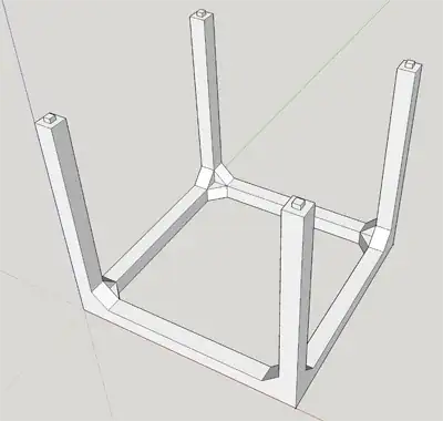

This is what my model looks like:
my wifeframe-ish partial cube model

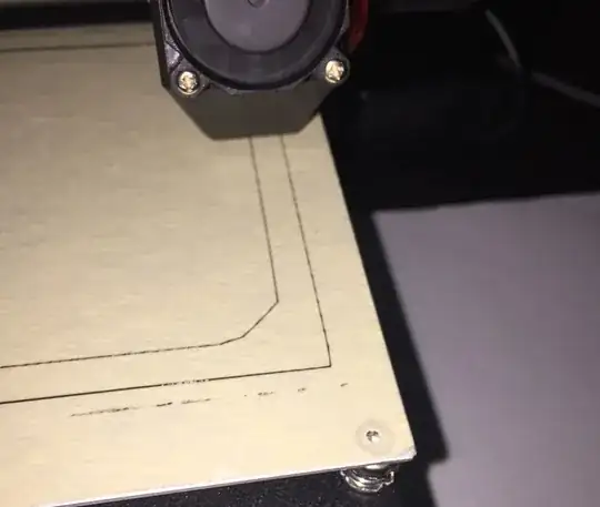

When I printed a good one yesterday, here is what the first two lines looked like:
good first layer

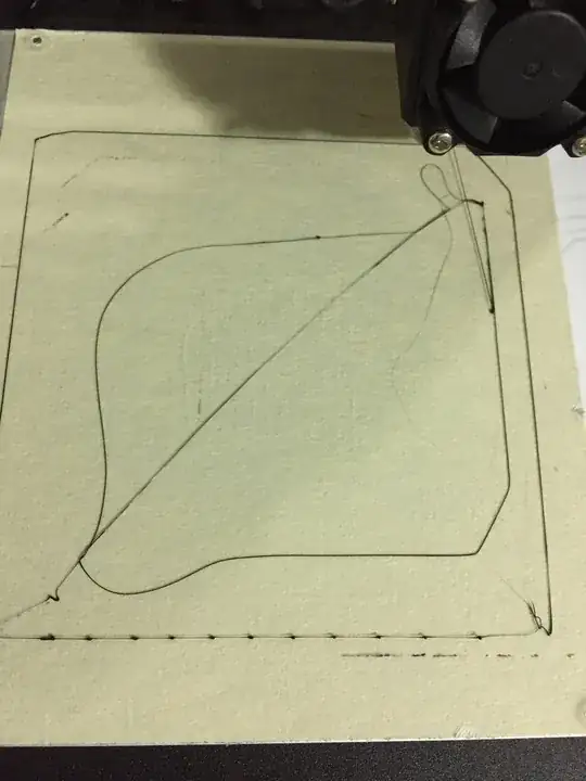

When I print today, even after multiple attempts to level the bed, this is what the first layer tends to look like:

Your nozzle is clearly too far from the bed. The plastic should be squashed down slightly. Some firmwares have an option where you can adjust the height of the nozzle "live" during the first layer, in Marlin this is called "babystepping". This can be very useful because you can get the height correct without having to mess with the physical leveling of the bed.

Eureka! All of the other answers and suggestions on this post were all very helpful, and would likely be the right answers 90+% of the time, but they didn't give me any relief. I spent a bunch of time watching YouTube videos about 3D printing and I started to notice a difference in size of the lines of plastic being laid down on the build plate.
In the videos, the lines of plastic looked bigger. Mine were very fine lines. That lead me down a series of different search terms until I found some other videos that talked about nozzle cleaning.
I noticed that one of the symptoms they mentioned was that when the plastic would come out of the nozzle that it would curve around. That's a sign that it's partially blocked and causing it to bend and curve. After the people in the YouTube videos cleaned their nozzle, the plastic would then extrude and drop straight down.
If my nozzle was partially blocked and only about half the right amount of plastic was coming out that would make sense since there wouldn't be enough surface area of the plastic to make a good connection to the build surface.
I acquired some 0.4mm drill bits from Amazon and followed the instructions on this YouTube video.
Sure enough, when using the 0.4mm drill bits, I could tell the nozzle was clogged. After clearing it out, the plastic started extruding in a straight line down, just like the video. I was stoked!
I tried another print and it was NIGHT AND DAY. I was finally getting nice plump lines that stuck to the build plate. I still had an issue or two on certain parts of my build plate, but I think that's because in all of my tries I had damaged the masking tape. I put down new blue tape and started up my print and it's BEAUTIFUL.
Thank you all very much for your help. Hopefully, this will be helpful to someone else as well.

Your photo has shadows which seem to suggest that your tape layer has some wrinkles. That won't help. Try removing that tape and laying down the fabulous blue painter's tape.
