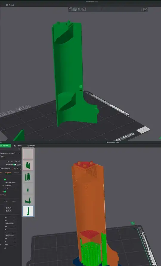

The top image is one such model in the official suggested orientation. It is designed to be completely support free, but has poor bed adhesion.
The bottom image has additional "unnecessary" supports added to give it a significantly increased surface area on the bed.
Example
Is this an effective way to improve bed adhesion?

Anything that increase the contact surface withe the bed and is attached with the part will help with adhesion, so using unnecessary support can work, however as you will have to build it for many layers it is neither efficient in terms of wasted material, nor in terms of time.
The solutions you do not want to discuss, notably the brim should solve this type of problem in a more efficient manner.

Yes, and despite being a waste of material, this is arguably a good strategy. A very tall and thin part like this not only has poor bed contact for adhesion, but may flex under change in direction of motion of the bed (under acceleration), or under drag from the toolhead as it extrudes new material. This is particularly a problem with less-rigid (even moreso with fully flexible, like TPU) material types. Flexing of the existing part of the print while new material is being deposited on top of it can produce dimensional inaccuracy of the final part, as the relative positioning of features is less than perfect.
Adding brims or modeled-in bed surface contact features or whatnot will do nothing to solve this problem, but "gratuitous" supports will.
