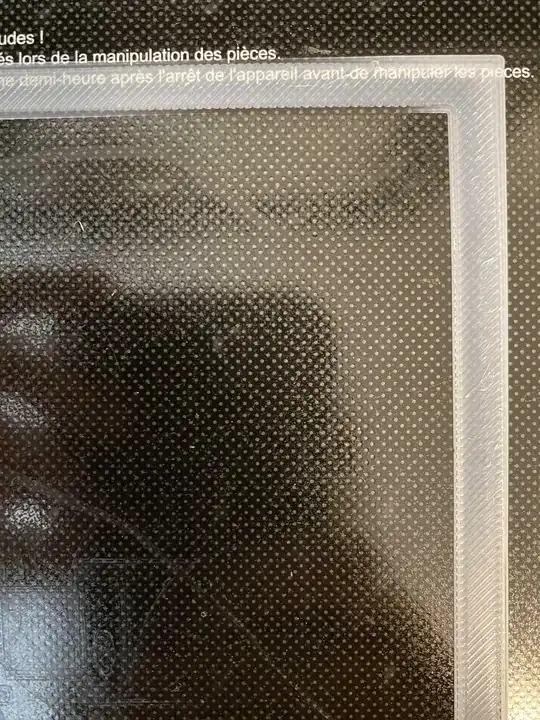

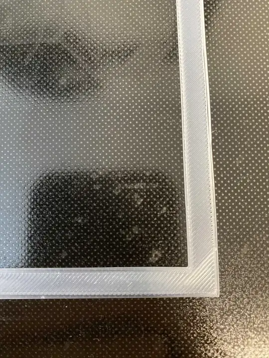

I have an Ender 3V2 running a custom version of Jyers Marlin, and using a CR Touch as a Z-stop, and with a heated glass print bed. This is my first printer, and it mostly prints fine except when printing near the edges where some imperfections with bed leveling mess with bed adhesion and have definitely ruined a couple of my prints. The main issue is that the first layer is very uneven, where in some places filament it basically smeared onto the bed whereas in other places the filament is barely touching the bed. What's stranger still is that generally speaking, the infill seems to be more consistent in terms of z-height on the first layer, whereas the walls have much more variation. I've included some photos to illustrate the issue:
This is the entire leveling test I printed (it only tests the edges because the center is fine). This was run without UBL - I verified this as the Z axis motor didn't move during the print (it's only 1 layer).
enter image description here This is what has been causing me the most issues. In the top right corner of the print, the wall filament basically disappears for about 1-2 inches because the nozzle is too close to the bed. This is pretty close to the top right leveling screw as well. You can also see that only the walls are affected, as the infill is pretty even across the same area.
enter image description here Kind of the opposite issue in the bottom right compared to the top right, where the walls are printed too high off of the bed and start to string from poor adhesion. Once again, the infill seems to be ok (except in the corner).

Edit 1: Took off the X/Z carriages and found two abnormalities - not sure if these are causing the issue. The nozzle carriage has a bit of space between the bottom of the X-axis profile and the roller. It doesn't really wiggle during printing, but it could if I touched it; right now, the two rollers on top sit nicely on the profile. Also, these rollers all have a slightly discoloured ring where a little bit of material has been shaved off of the roller. The Z-axis rollers on the side opposite the lead screw are the opposite case, where the rollers have to be forced onto the structure since it's so tight.

Just for anyone stumbling across this thread now: as it turns out, the wheels on the x-carriage (print head) were installed at a slight angle and not screwed in as tight as they were supposed to be, which probably led to some inconsistencies in printing.
