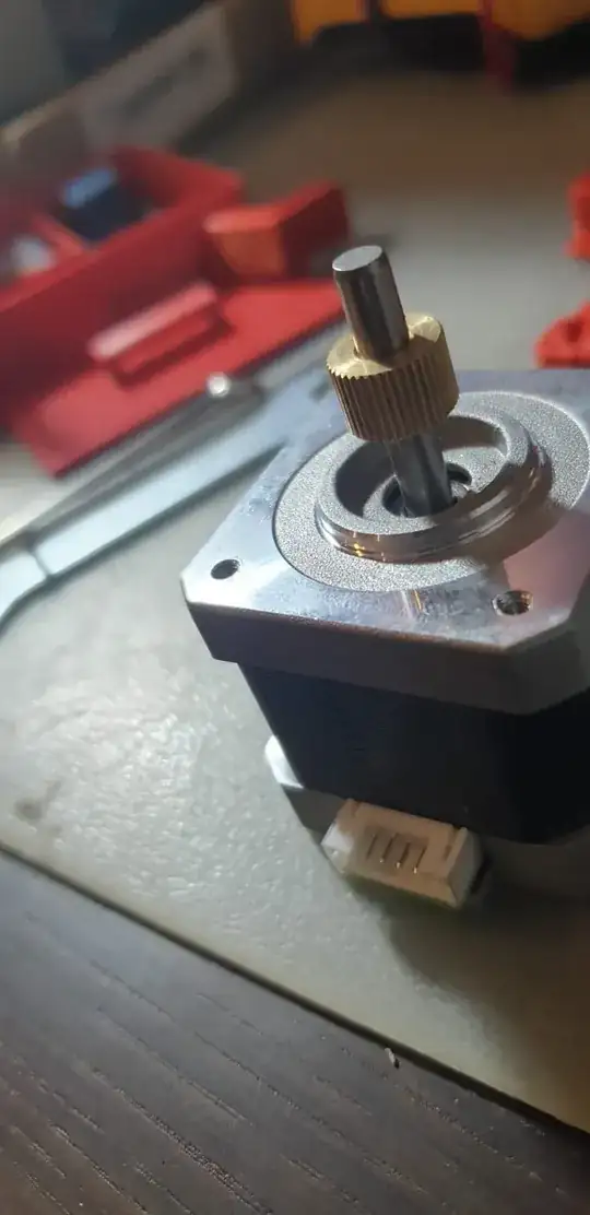

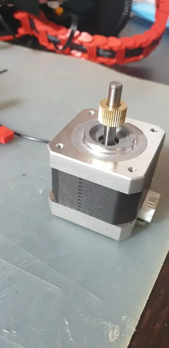

I am very new in the 3D printing scene. After a lot of searching for my specific problem (and didn't find any answers, of course) I decided to reach out.
I bought a Creality Ender 3 Pro in November and after a few days of lovely prints I decided to upgrade the printer with a glass bed and "Aluminum Dual Gear Pulley Dual Drive Extruder Kit".
The Problem, as you might expected already, is with the installation of the dual gear extruder. I have watched a dozen of YouTube videos, and all of them have something I don't – a screw in the stock gold gear on the extruder motor.
How can I install the Aluminum Dual Gear Pulley Dual Drive Extruder Kit if I take the gear out? Should I try remove it with force? Please if someone has come across the same situation, that there isn’t a screw In the stock gear on the extruder motor and mange to take it out, please tell me. I'm adding a picture so you understand what I mean.

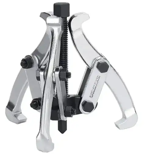

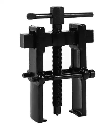

I had exactly the same problem with an Ender 3 Pro I bought a couple of weeks ago (Mar 2021) and I was able to remove the gear easily with a small gear/bearing puller... take a look at Amazon and you will find plenty of selection.
The 3-arm puller works better as it's much more stable when pulling the gear (this is the one I have). Both work in the same way; the arms/jaws attache to the bottom of the gear and the tip of the top screw pushes the motor shaft down.

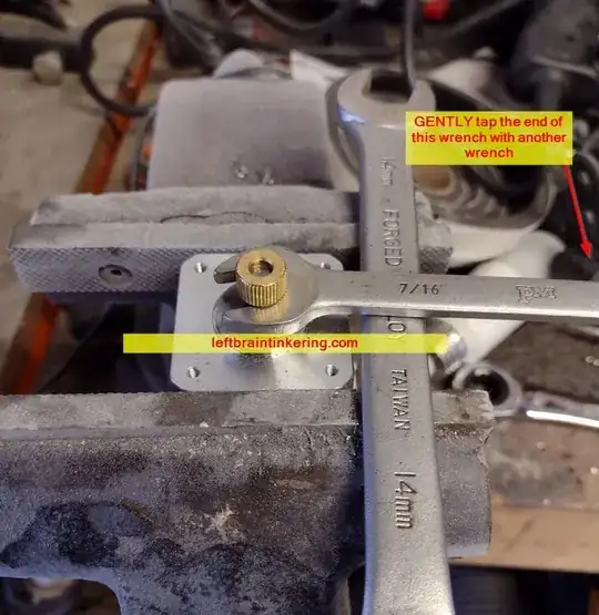

I accomplished this by using a pair of open-end wrenches and some heat.
  1. Heat the brass gear end with a butane torch or a MAP gas torch
  2. Clamp the stepper motor into a vice
  3. Position two open-end wrenches such that you can use the open-end part of one open-end wrench underneath the brass gear while the second wrench is positioned perpendicular to the first one, underneath it (photos in below article will help visualize)
    Using a couple of wrenches to pop the brass gear off of the motor
  4. Gently tap on the end of the first wrench, to release the brass gear
  5. Install the new gear, but you will need to grind a small flat on the shaft of the stepper motor so that the set screw has a landing.
The idea is basically making a lever out of one wrench, and using impact force to release the gear.
See this article for visuals: Micro Swiss Direct Drive Installation for Creality Ender 3 Pro with a Press-Fit Extruder Gear
