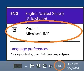

  2. I can't see the language bar nor the language toggle popup when I swap:

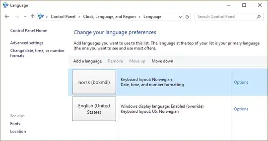

Here are some screenshots of my settings:
settings 1
settings 2
settings 3
No language bar on the toolbar

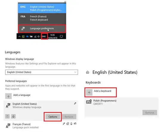

2018/2019 answer:
I had the same issue, trying to use Polish keyboard with English UI language of Windows.
Every time I locked the computer, it came back to US keyboard.
The problem was that I was having Polish keyboard under Polish language, where in fact, what I really wanted was a Polish keyboard under English language.
I removed Polish language pack, added Polish keyboard under English language, and removed American keyboard from English language - see the screenshot below:
Windows 10 (2018) language preferences
So in short, the trick is to add your desired keyboard as the only keyboard under the default language.
(This works for me because I generally type in English, only sometimes I want to input in Polish, but I can do it without changing the keyboard, since Polish keyboard is fully compatible with US QWERTY).

Turns out I had to configure a keyboard layout in the first screenshot. You'll notice it says "Keyboard: None available". So clicking "Options" here, then "Add an input method" and then selecting QWERTY Norwegian solved the case.
I don't know how I was able to install Windows with such a borked language setup. Anyway I advice everyone to watch more closely the language questions upon initial install.
