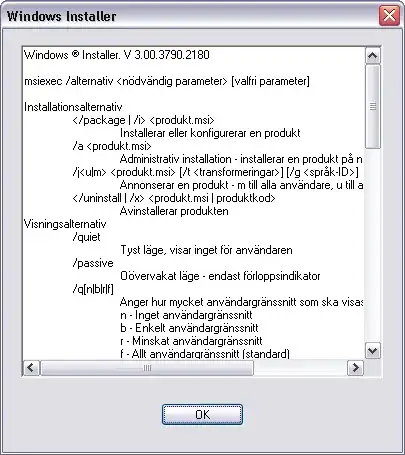

So I checked my Windows Installer version.
C:\>msiexec
windows installer
As you can tell by the screenshot above I had version 3.00.3790.2180.
