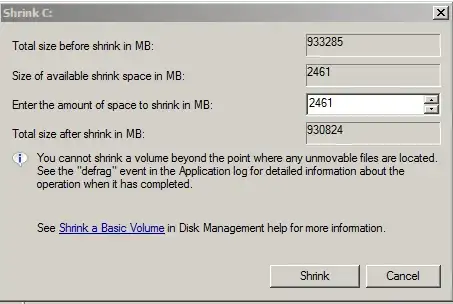

I have a 900GB HDD, but for some reason it will only allow me to shrink like 2500MB of it. In the past, I could shrink to my desired size, but for some reason it is giving me a problem now. I have tried defragging it with PerfectDisk, but I actually think doing that made it even smaller. I have also tried using cmd diskpart but that fails too. Heres a pic:
Shrink C

The main reason for not being able to shrink the disk are that there are unmovable files on the disk at the time of trying to shrink the volume (as your screenshot says).
The most common "unmoveable" files are files which are locked during normal computer operation such as virtual memory/pagefile/system restore files as well as a few other files which may be open, but not running "in memory"
Having come across this myself previously on both server and desktop operating systems - I can say the most likely culprit is the pagefile.

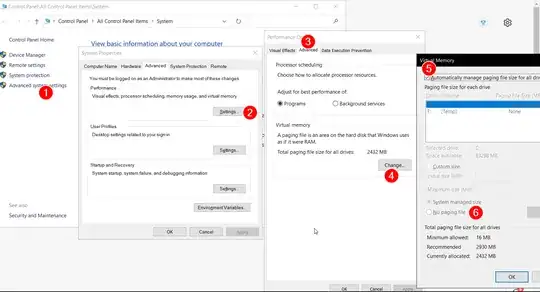

To fix this:
  1. Right-click Computer
  2. Select Properties
  3. Select Advanced system settings
  4. Select the Advanced tab and then the Performance radio button
  5. Select the Change box under Virtual memory
  6. Un-check Automatically manage paging file size for all drives
  7. Select No paging file, and click the Set button
  8. Select OK to allow and restart.
Here are the steps on Window 10: enter image description here
Once your machine has rebooted and you know you have no page file (check at the root of C: with hidden and system files showing) - try a defrag and then try shrinking the volume again.
Don't forget to reset your pagefile back to its original size afterwards! Failure to do so will potentially cause significant performance issues with any machine.
