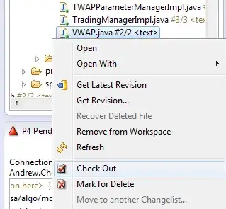

The only perspectives I use are Java and Perforce, and normally I check out a file via Perforce, like so:
Checking out a file via Perforce
Once checked out, it looks like this:
A file checked out via Perforce
But I can't edit this file. Meanwhile, you see the file directly underneath, "VWAPParameterManagerImpl.java"? I can edit that one just fine, checking it out using the same steps. Furthermore I was able to edit "VWAP.java" just yesterday@ I have also witnessed this happening with non-java files. In Windows Explorer, I checked the file's attributes and verifed it wasn't read-only (if that means anything; I didn't know what else to check).
