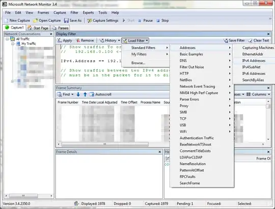

Once you have all the traffic flowing past your computer's NIC, grab a packet sniffer (I actually prefer Windows Network Monitor over Wireshark) and start grabbing the packets. You'll probably want to filter the traffic to just display the server in question. Filters in Microsoft Network Monitor are very user friendly: enter image description here
