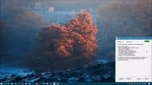

Windows is terrible at handling drives with unreadable sectors in file system meta data as it will try reading this sector Ad infinitum, where Linux does not. And Windows will try reading all drives and, if it's a recognizable file system, interpret the file system.
Here I capture what Windows does as soon as it discovers a drive (clearer video here):
If at any point it runs into a read error it will just keep trying. If this happens during boot the system will appear to be hanging. If you attach the drive while Windows is already running it may hang Explorer or even lock up the system. You may be able to prevent the latter by disabling auto-mount:
Type mountvol /n into an elevated command prompt and press Enter. You can then try imaging the drive, for example using DMDE free demo will do).
imaging a hard drive using DMDE
