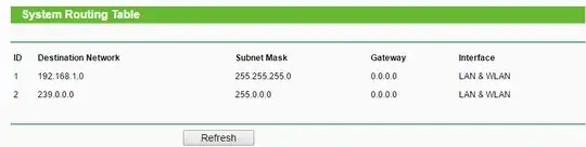

I am trying to use my router as an extension to my existing wlan. The connection seems to work fine, because I can ping the internet router from the tp-link. Also the status page of the tp-link shows an ok status.
If I am connected to the internet router, I can access the admin page of the tp-link. But when I am connected to the tp-link, I just can access this host and nothing else. The routing table of the tp-link looks like this:
The ip address of my internet router is 192.168.1.1, the address of tp-link is 192.168.1.99.
I need to have DHCP on tp-link on, otherwise I don't get an ip address.
Any ideas what is wrong with this setup?
