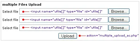

Reference: http://www.phpeasystep.com/phptu/2.html
