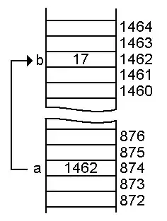

If a pointer stores the address of a variable ... then from where do we get the pointer?
What I asked was that if we are using pointer directly, then there must be a location from where we get this pointer?
Yes, a declared pointer has its own location in memory.
In the example above, you have a variable, 'b', which stores the value "17".
int b = 17; /* the value of 'b' is stored at memory location 1462 */
When you create a pointer to that variable, the pointer is stored in its own memory location.
int *a;
a = &b; /* the pointer 'a' is stored at memory location 874 */
It is the compiler's job to know where to "get the pointer." When your source code refers to the pointer 'a', the compiler translates it into -> "whatever address value is stored in memory location 874".
Note: This diagram isn't technically correct since, in 32-bit systems, both pointers and int's use four bytes each.
