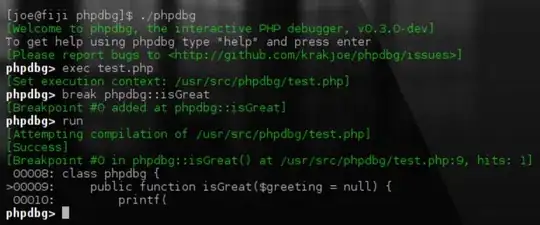

The Interactive Stepthrough PHP Debugger implemented as a SAPI module which can give give you complete control over the environment without impacting the functionality or performance of your code. It aims to be a lightweight, powerful, easy to use debugging platform for PHP 5.4+ and it's shipped out-of-box with PHP 5.6.
Features includes:
See the screenshots:
Home page: http://phpdbg.com/

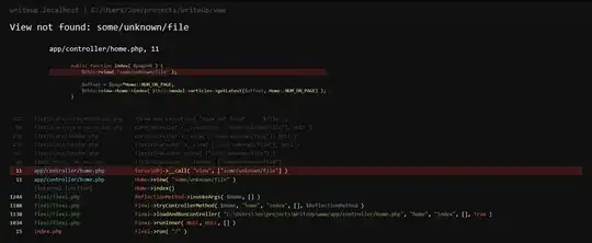

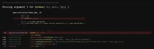

This is very easy to use library (actually a file) to debug your PHP scripts.
The only thing that you need to do is to include one file as below (at the beginning on your code):
require('php_error.php');
\php_error\reportErrors();
Then all errors will give you info such as backtrace, code context, function arguments, server variables, etc. For example:
Features include:
Home page: http://phperror.net/
GitHub: https://github.com/JosephLenton/PHP-Error
My fork (with extra fixes): https://github.com/kenorb-contrib/PHP-Error
