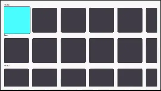

The proper behavior should be the following image. Pressing DPad down should focus to the first item, and up should bring to the last saved state focus child.
