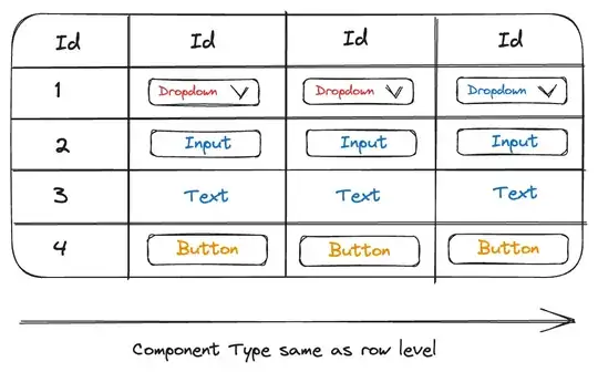

By customizing cell rendering, you can achieve this row-level cell association with the MUI X Data Grid. This allows you to define a custom component that will be rendered for each cell in the grid.
To do this, you need to pass some additional data to each row, such as the type and color of the cell component. For example, you can have different types of cell components, such as button, input, select, or text. You can also have different colors for each cell component, such as primary, secondary, or default.
Then, you need to create a custom cell component that will render different elements based on the type and color of the row data. For example, you can use MUI components such as Button, TextField, Select, or Typography. You can also use props such as value and field to access the cell value and field name.
Finally, you need to pass your custom cell component to the renderCell prop of each column in the grid. This will override the default rendering of the cells and use your custom component instead.
