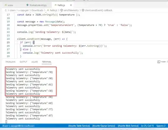

I am still pretty new to digital twins/IoT and am currently working on a digital twin solution using simulated data from the IoT Hub VS Code extension. I can successfully send the simulated telemetry data to my IoT Hub however when I try to forward it onto my ADT instance using a Function file it is not being received.
However I can see that the messages are being received in ADT and being executed in my function file while I run the code. However when I update my query in ADT it is not picking up these messages and displaying them within the explorer.
Any help will be greatly appreciated as I have hit a bit of a wall with it today!
From my thoughts there are 3 possible causes that might stop it from receiving the telemetry data.
The Azure Function code - I have checked this over a couple times and have even checked with chat gpt to ensure this is correct.
The DTDL model in ADT - I based this off of the working version of a twin I made before using a virtual raspberry pi and just added the simulated data sources which I was including.
The Event Grid - Not 100% sure about this being the cause as from what I know of the process however I did the exact same set up as I did with my previous working project.
I have tried setting up again in a new environment as well as changing the DTDL and Function file however that did not seem to change anything.
Here is the code used in my simulated device (Node.js):
