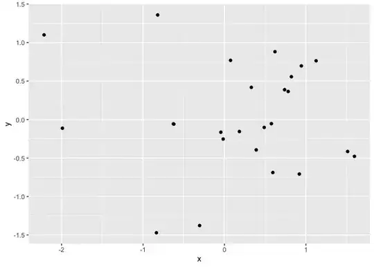

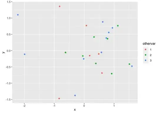

make_scatter_string(dat,'test1.png',colorvar='othervar') # Works, aes_string can handle shapevar being NULL
make_scatter_data(dat,'test2.png',colorvar='othervar') # Gives error message "Error in `.data[[NULL]]`: ! Must subset the data pronoun with a string, not NULL."
make_scatter_sym(dat,'test3.png',colorvar='othervar') # Gives error message "Error in `sym()`: ! Can't convert NULL to a symbol."
