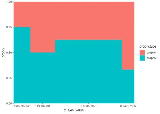

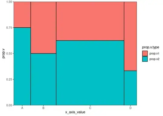

I want to create a plot with two continuous variables (v1 and v2) and one categorical variable (ex levels A,B,C,D). The plot should show a matrix of proportions. The categorical variable should be on the x-axis and each column should have two boxes (v1 and v2) representing the proportion of each continuous variable within that category (Within A, v1/(v1+v2) then v2/(v1+v2)). The width of the columns should represent the proportion of the total that is within that category (v1+v2 for A divided by the sum of all v1 and v2)
It should look like a heatmap but with the variable type (v1 or v2) mapped to color and the height and width of the boxes mapped as described above.
Using a stacked bar graph approach worked well and is close to what I want but there is horizontal space between the bars. Since I'm already using the width aesthetic to map the proportion within each category I wasn't able to eliminate this space.
Alternatively I tried to use geom_tile but that suffered from the same space issue and didn't result in all bars with a height of 1.
The closest solution I have found is: ggplot2 heatmap with tile height and width as aes()
However in that example they have a categorical variable on both X and Y axes which is a little different than my case.

ggplot(df,aes(cat,prop.v, fill = prop.v.type))+
geom_bar(position = "stack", stat = "identity",aes(width=prop.cat))
ggplot(df,aes(x=cat, y=prop.v, fill = prop.v.type))+
geom_tile(aes(width=prop.cat,height=prop.v))
