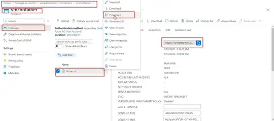

- You can find the
fileUris by navigating to the following path.
Azure Portal > Storage Account > Your Storage Account > Select your Container

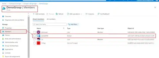

A custom extension is created in the Azure VM once the ARM deployment is complete, and the device is also added to an Azure AD group.
